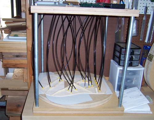

How steady is your go-bar deck? I originally just used all-thread as the "columns" in mine, pretty wobbly. I was also using 1/4" rods which I think are too stiff for go-bars, so it was pretty precarious. I cut some 2" PVC pipe on a miter saw to use for the columns, and just used the all-thread to tighten up the upper and lower deck to the PVC. I also switched to 3/16" rods. Huge, huge difference, way more stable. I'm still planning on doubling the thickness of the upper deck so I can use more go-bars at the same time.
Before:
After:

PostPosted: Tue Jun 13, 2006 7:55 am
How about a bunch of bungy cords hooked onto the vertical rods, creating a mesh of sorts - the problem is you need to get in there and be able to manipulate the rods.
PostPosted: Tue Jun 13, 2006 8:27 am
Mine is three layers on the bottom, two on the top, with steel conduit covering the all-thread. Built like a tank.
The conduit is countersunk 3/4" into the top and bottom also.

I did the same as Jon, and need to add thickness like Ron's.
Just got my new batch of 3/16" fg rods. The accumulated force from the 1/4" ones when gluing plates was just too scary.
